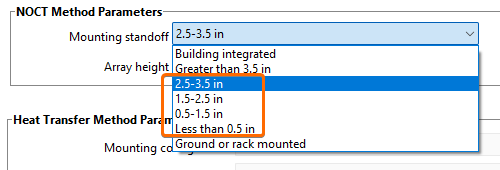

The way the code is set up, an adjustment is only applied for the options shown in the orange box:
This means that for building integrated, greater than 3.5 inches, and ground and rack mounted, an adjustment is not applied.
Based on that information, the "building integrated" option in SAM allows for free flow of air behind the module.
I think the original source of this approach is from the "Estimating INOCT from NOCT and Mounting Configuration" section starting on page 10 of the attached Fuentes, M. (1987). A Simplified Thermal Model for Flat-Plate Photovoltaic Arrays. Sandia National Laboratories. SAND85-0330. However, he does not mention a "building-integrated" option.

21 May 2025 11:27 #14055
Replied by Paul Gilman on topic Question on cell temperature model for BIPV
Hi Jesus,
The "building integrated" option here is a bit misleading. I think it was originally intended to represent solar windows with conditioned air in contact with the back of the solar cells.
If you want to model a building-integrated array with limited airflow behind the module, I would recommend using one of the other options.
