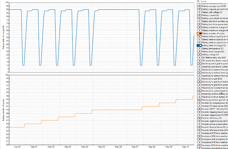

I am running simulations of PV+Battery and we are very interested in the battery degradation over the lifespan. We have recently found some inconsistencies in how SAM counts the number of cycles.
How does SAM count the discharges below the set depth of discharge (I have set it to be 80% DoD). Ie when DoD is 40%? (As per my attached image).
In the attached image, there are some inconsistencies as to how SAM has calculated the number of cycles. This has raised the question regarding the validity of the battery degradation.
So how does SAM count the number of cycles? Is this value accurate when determining the lifespan of utility scale BESS?

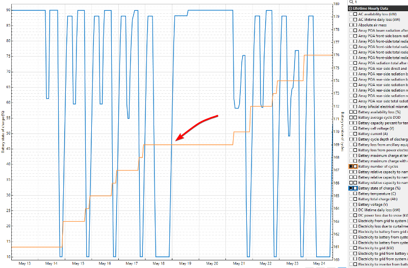

The following graph from case "2B" shows an example where the cycle counting algorithm appears to miss a charge/discharge cycle:
SAM uses a rainflow cycle count, which takes some time to wrap one’s head around: en.wikipedia.org/wiki/Rainflow-counting_algorithm .
The graph above shows a total of 13 cycles over the period of 11 days. The rainflow algorithm was designed for stress-strain testing based on analysis at the end of an experiment. Our our real-time adaptation for SAM sometimes has “delayed” cycle counts. Cycles being delayed by 2-3 days shouldn’t have a big impact on SAM degradation calculations.
There is a debate in the battery literature about the best method for cycle counting. SAM uses rainflow counting, but full equivalent cycle counting and other methods are under discussion: www.sciencedirect.com/science/article/pii/S2352484722022946 .
The rainflow method was popular when we first implemented SAM's battery model, and we have not had a chance to re-evaluate the latest literature and make updates.
As of SAM 2024.12.12, the battery models line up well with results from github.com/NREL/BLAST-Lite . For a high-level overview of that comparison see Mirletz, B.; Guittet, D. (2022) Recent Improvements in PV+Battery Modeling in NREL's System Advisor Model. 2022 PV Performance Modeling Workshop. NREL/PO-7A40-83677 ( PDF 1 MB ).
If you are concerned about SAM underestimating the number of battery charge/discharge cycles, you could either adjuste the battery bank replacement threshold on the Battery Life page, or use the "replace at specified schedule" option to force a battery replacement so they are accounted for in the project costs.
