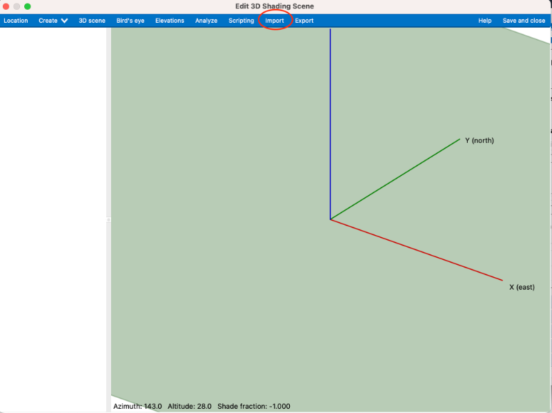

Importing 3D files
- Henry
12 Feb 2025 22:35 #13868
by Henry
Importing 3D files was created by Henry

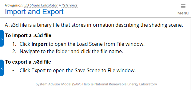

Hi Henry,
SAM's 3D Shade Calculator does not automatically import data from CAD software. The Import and Export buttons export files in the special .s3d format so you can save your shade scenes. From the calculator's Help system:
SAM's scripting language LK Script is integrated with the 3D Shade Calculator, so it would be possible to write your own code to import CAD files.
