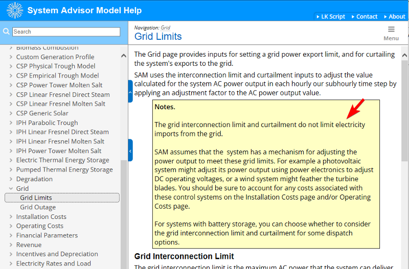

I am trying to simulate a stand-alone BESS to extract the state of charge curves of the batteries and the power injected into the system. I am considering a grid limitation of 30 MW, however, this limit is only being respected during discharge. During battery charging, the system exceeds -35 MW. Is there any parameter I might be missing?

Hi Vitor,
The grid limits only constrain exports to the grid. They do not limit imports. This is explained in the Grid Limits Help topic:
Based on the manual dispatch parameters on the Battery Dispatch page, the battery is only allowed to discharge to the grid during Period 2 from 5pm to 8pm, and to charge from the grid from 10am to 1pm. The time series plot in the screenshot you shared looks consistent with this dispach schedule.
