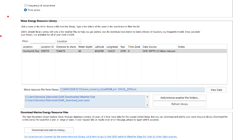

I would like to simulate the wave resources of a location in Norway. I have adapted the data to the format required by SAM but the file is still not working. I am not able to add the file to the library to simulate the resource.
Could you please check the file and let me know if something is missing or has to be corrected.
