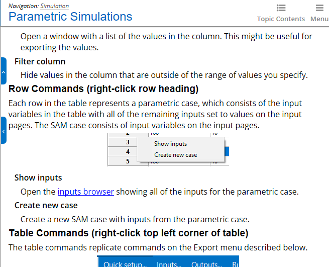

The "tips and tricks" section of the Parametric Simulations topic in Help explains how to create a case with inputs that match a given parametric run. You can use this technique (right-click row heading and select Create new case) to see all of the outputs for a parametric run:
The "test 10 kWt pv.sam" file you attached does not seem to have anything set up on the Parametrics page.
You may want to also create plots of "Irradiance DNI from weather file (W/m2)" to see the effect of the irradiance data on the results.

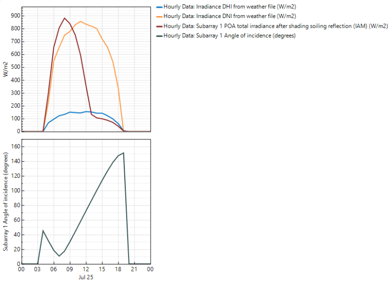

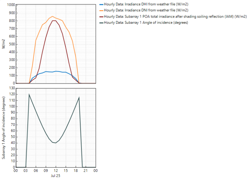

Attached is a copy of your file with a case that I generated from the Parametrics page for Run 6, and one that I created for Azimuth = 180.
On the Time Series tab, I plotted the following variables:
Irradiance DHI from weather file (W/m2)
Subarray 1 Angle of incidence (degrees)
Subarray 1 POA total irradiance after shading soiling reflection (IAM) (W/m2)
For Run 6, Tilt = 70°, Azimuth = 100° (facing E/SE):
And for Tilt = 70°, Azimuth = 180°:
For the east-facing array, the plane-of-array (POA) irradiance is greater in the morning than at noon because it collects more solar energy in the morning when it is facing the sun. For the south-facing array, the maximum POA irradiance is at noon.
