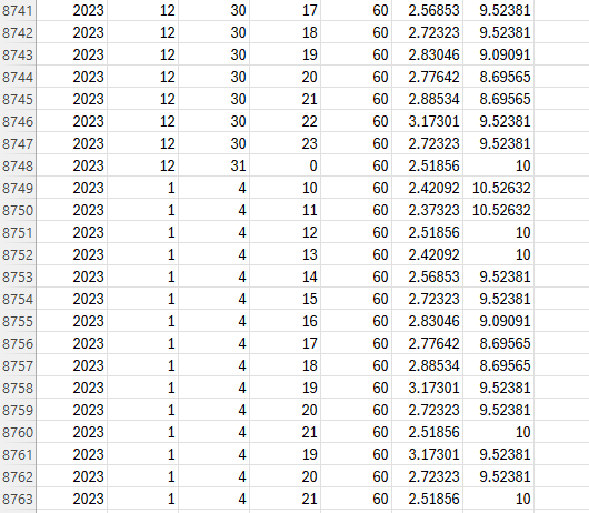

Each row must have data matching the column headings. Rows 746, 1467, 2212, etc. have "x Total" instead of time stamps. Search for "total" to find these rows.
Also, you may need to reorder the rows to start January 1 Hour 0 and End December 31 Hour 23.

Thank you. Something else must be going on. Please take a look and tell me why I can still not see my data set.

The most recent file you attached has only 8757 data rows. It should have 8760 data rows from Janary 1 to December 31 plus the three header rows for a total of 8763 rows.

Thanks, I just fixed that, and nothing changed. Still not loading
