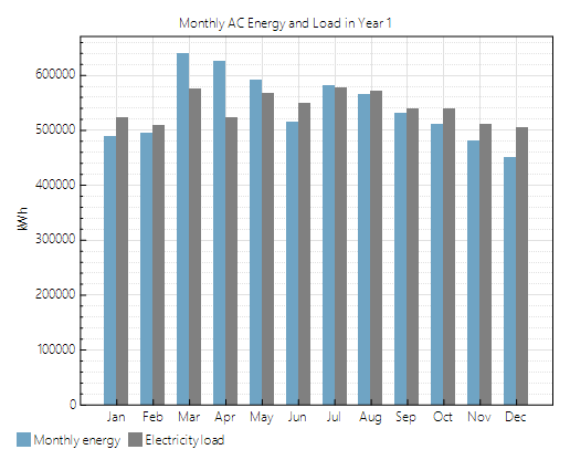

HiI just ran a simulation of a 3.4 MW microgrid and have some questions about the results. Does the Annual AC energy in Year 1include power from the utility (grid) as well as the microgrid? Because the summary window shows Year 1 AC energy of 6,469,720 kWh but when I dig into the table data, I calculate that my total system energy (system to load + system to battery) is 2,928,363.19 kWh with the utility accounting to 3,554,595 kWh, meaning my system only covers about 45% of load despite me trying to size it to cover as much as possible. If the AC energy does include utilities then the AC energy and load graph makes more sense(attached). If the Year 1 AC energy is just from the microgrid how could I see that breakdown/where the energy goes?
I’ve attached the SAM file. I want to make sure I’m reading the results correctly and getting an accurate picture of how well the microgrid is servicing the load.Thanks!Michael

The "Annual AC energy in Year 1" value shown in the Metrics table on the Summary tab of the Results page is the total energy delivered to the load and grid over the year. It is the sum of the hourly "Electricity from system to load (year 1 hourly)" and "Electricity to grid (year 1 hourly)" values.
The "Monthly AC Energy and Load in Year 1" graph on the Summary tab shows that for most months, the total load is slightly more than the total energy from the system. For March, April, May and July, the system generates more electricity than the total load:
