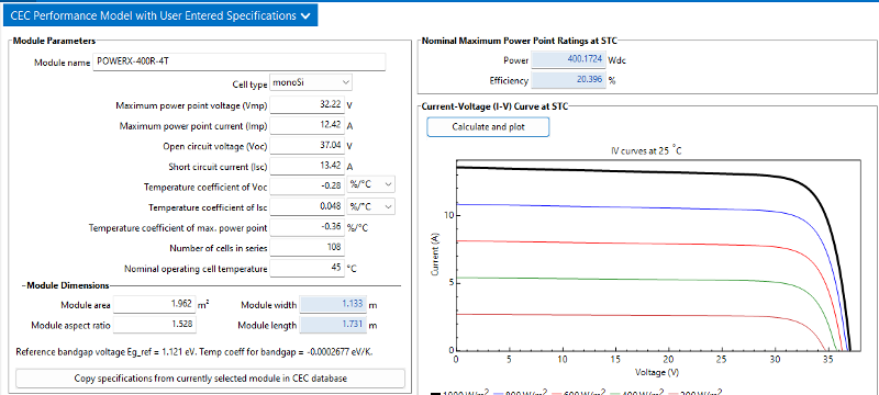

In the meantime, I did some experimenting with the parameters for the Solaria POWERX-400R-4T module, and found that the coefficient calculator's solver works using parameters from the datasheet with modified values for Vmp and Imp: Vmp = 32.22 and Imp = 12.42. These should result in a reasonable I-V curve for modeling a PV system based on this module.
Here is a screenshot from the file you attached showing the results with these parameters:
