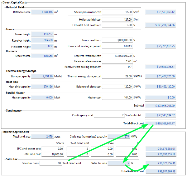

II question- The final cost results from the SAM model mention the total installed cost as $2 billion, but the sales tax cost is $65 million: 5% (sales tax rate) of $2 billion is $100 million- any possible reason for this discrepancy?

In SAM, the sales tax is a value-added tax. It is a percentage of the direct costs specified on the Installation Costs page that is included in the project's total installed cost.
The sales tax is the product of total direct cost, sales tax basis, and sales tax rate:
