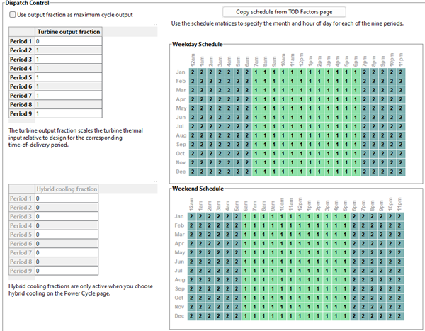

I am trying to model a CSP Solar Tower that will only operate the power cycle during night, how can I control this setting from SAM? I want to model and understand the sizing of my TES when it is charged during the day and only utilized after the solar resource is gone. Which parameters in the software I can play with to model this behaviour in my system?

Replied by Paul Gilman on topic Night Production
