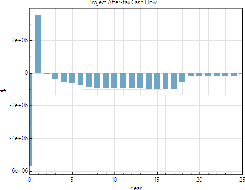

You can use the "Project After-tax Cash Flow" graph on the Summary tab of the Results page to see why the NPV is negative:
In this case, the only year with positive cash flow is Year 1, so the project does not earn enough after-tax revenue to cover the Year 0 cost.
The Help topic for Net Present Value discusses some ways to improve the project economics when the NPV is negative: samrepo.nlr.gov/help/mtf_npv.html (or press F1 in SAM to open Help there).
