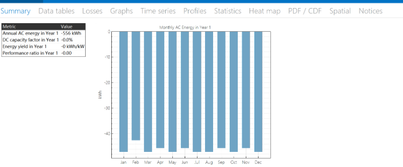

Replied by Paul Gilman on topic PV model
Hi Morry,
Negative total monthly output usually indicates a problem with the inputs. You might try looking at the Losses tab on the Results page to see what is causing the problem.
Please attach a copy of your .sam file if you would like me to help troubleshoot.
