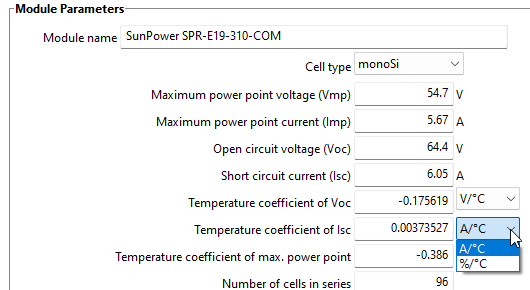

I am simulating a system with a CdTe module not in the CEC database. I have input all the values according to the manufacturer's specifications sheet but when I tried to plot the IV-curve, I got the following error: Could not solve, sanity check failed (-2): Il < 0.5 || Il > 20.0
My hunch is that SAM does not accept PV modules with short-circuit current values of less than 0.5A and more than 20A. Is my hunch correct? If not, could someone please let me know what that error might be and how to fix it?

Not sure if this has been solved or if anyone found a solution. I got the same problem as Koami describes and the error still appears when the temperature coefficients of Voc and Isc are in their correct units %/°C.
It seems that SAM does not allow for modules with short-circuit currents (or maximum power current) below 0.5 A. Since the error is Could not solve, sanity check failed (-2): Il < 0.5 || Il > 20.0
However, many semi-transparent CdTe modules in the market have currently these currents below 0.5 A. Is it possible to override that sanity check, or lower the lower limit in SAM?
