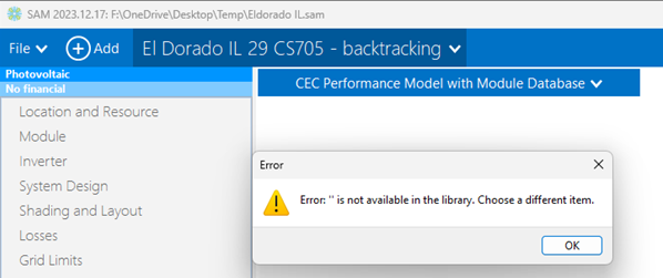

This error is caused by the library error on the Module page:
To fix the problem:
To fix the problem:
- Open the "Eldorado IL.sam" file and go to the Module page.
- At the top of the page, switch from CEC Performance model with User Entered Specifications to CEC Perfomance Model with Module Database.
- When you see the error "Error: '' is not available in the library. Choose a different item." error, click OK. You may need to click it two or three times.

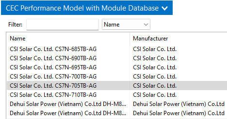

- Choose any module in the library.
- Switch back to CEC Perfomance Model with Module Database.
