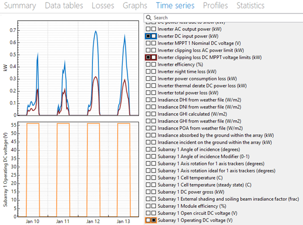

The "0.8bifacial DC/AC = 1.9" case uses a 606 Wac inverter with minimum and maximum MPPT voltage ratings of 52-56 Vdc. If the array operating voltage exceeds 56 Vdc, this inverter clips the inverter input voltage to 56 Vdc:
The "0.8bifacial DC/AC = 1.6" case uses a 708 Wac inverter with minimum and maximum MPPT voltage ratings of 50-64 Vdc. This inverter clips the inverter input voltage to 64 Vdc.
You can see the effect of inverter clipping in the results by displaying the following variables in the tables on the Data Tables tab or plotting them on the Time Series tab:
Attached is a modified version of your file. I created two cases that are identical exept each uses a different LeadSolar Energy inverter.
- Subarray 1 Operating DC voltage (V)
- Inverter DC input power (kW)
- Inverter clipping loss DC MPPT voltage limits (kW)
Last edit: 05 Apr 2024 10:29 by Paul Gilman.

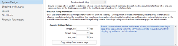

If you want to remove the effect of inverter voltage clipping, you can set Vmppt_high on the System Design page to a value higher than the array's maximum operating voltage. To avoid inverter power limiting, you can choose an inverter with a higher power rating.
