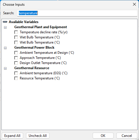

I don't see "Reservoir temperature" as an available input for Stochastic simulations:
However, I was able to replicate the crash with other input variables.
The Geothermal model is not well suited to stochastic simulations. You may want to try changing input variables and running simulations manually.
