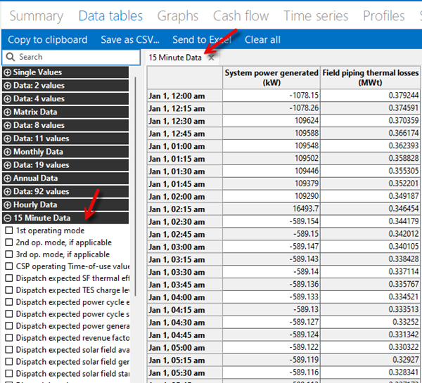

how dose the SAM show the results as per 15 min interval when our resource data are as per 15 min interval in the trough physical model? Or how can we solve this problem?
19 Feb 2024 18:04 #12913
Replied by Paul Gilman on topic The results showed as per 15 min interval
