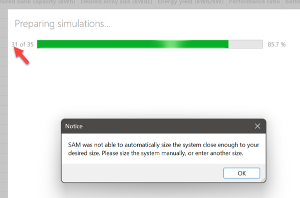

Thank you for your reply. I understand, now I have decreased the inverter power to 0.5kW and enabled the estimate subarray 1 configuration, so that an appropiate number of inverters can be selected to keep a DC to AC ratio close to 1.2. I have also dereased the battery power to 2kW. I have also added the other variable outputs you suggested.
However, now when I try to run the parametric simulation I get this message several times.

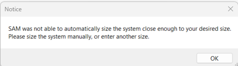

Then I get this message,

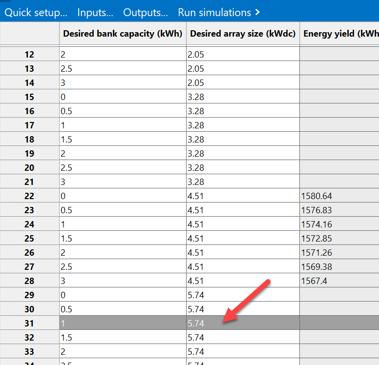

For some of the desired sized in the parametrics table, the sizing algorithm fails. For example, Run 31 fails:
You can see what the inputs are for Run 31 in the Parametrics table:

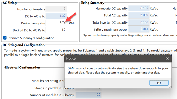

You can test that desired array size on the System Design page:
A better approach might be to disable the Estimate Subarray 1 configuration option, and instead change the number of strings in parallel to change the system size. You'll also have to change the inverter size. Or you could try using a small module (maybe around 120 Wdc) and small inverter (around 100 Wac to work with the 1.2 DC/AC ratio).
