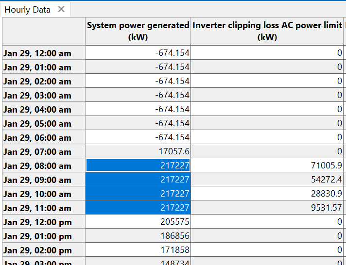

Getting a constant output if there is a clipping loss in inverter how to solve i
- Amrit Dash
19 Dec 2023 02:19 #12763
by Amrit Dash
Getting a constant output if there is a clipping loss in inverter how to solve i was created by Amrit Dash
19 Dec 2023 16:28 #12767
Replied by Paul Gilman on topic Getting a constant output if there is a clipping loss in inverter how to solve i
Hi Amrit,
SAM does not allow the inverter output to exceed its AC rated capacity. This function of an inverter is called power limiting.
I'm not sure how this is handled in PVsyst.
- Amrit Dash
21 Dec 2023 02:18 #12776
by Amrit Dash
Replied by Amrit Dash on topic Getting a constant output if there is a clipping loss in inverter how to solve i
Is there any way to model sam so that we can get different system power output when clipping loss occurs.
02 Jan 2024 16:56 #12793
Hi Amrit,
Yes. SAM limits the system's power to the inverter's AC power rating. It also limits the array operating voltage to the inverter's minimum and maximum MPPT voltage rating, which affects the system power.
