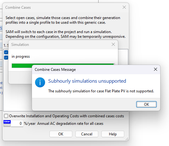

The Combine Cases feature does not support subhourly data. You should see an error message about that:
One solution to that problem is to manually run a simulation for each case, export the data to Excel to calculate the sums, and then manually import the resulting data on the Generic System Power Plant page.
You could also write an LK script to automate the process: sam.nlr.gov/lk-script.html
