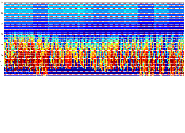

Hi folks
I've just run a grid-connected PV battery system with a custom load. I used default sizing options for the PV modules, inverter, and battery and used the peak shaving algo for battery dispatch. Why am I getting this weird jagged line output on the file?

Hi Aproop,
I'm not sure what you mean by "weird jagged line output on the file." If you need help troubleshooting, please tell me what output variable you are plotting, and if possible attach a .sam file or screenshot so I can understand your question.

Replied by Paul Gilman on topic Getting weird jagged lines on PV-Battery heatmap
Hi Aproop,
This is a rendering problem with SAM's data viewer for data with sub-hourly time steps. I created an issue on GitHub: github.com/NREL/SAM/issues/1616
Thank you for letting us know about this.
