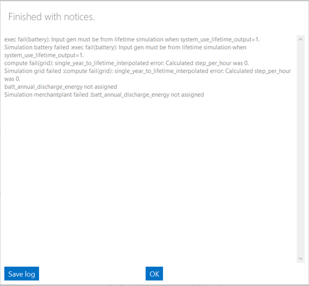

Im having problems with the code that I have attached in the message. The main point of the code is to set all the variables and simulate the case, but when i run the code and click on the simulate botton on SAM the following pop-up window appears.
I also detected that when i run the code the variable "grid_curtailment" is not being set, but when I delete that line of code, it operates properly. Why does this happen?

Replied by Paul Gilman on topic Problem with Standalone case and LK
Hi Jose,
Attached is a .zip archive with and LK script similar to yours and supporting files. This script sets the value of all inputs required for a Standalone Battery / Merchant Plant case. I think your script may be missing some input variables.
Note that my script requires three .csv files that store large time series arrays. These are included in the .zip file.
