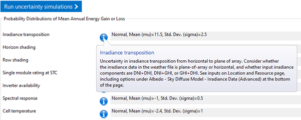

I have questions about the uncertainty analysis in the Detailed PV Model as follows (see screenshot below as a reference):
- What do these inputs mean?
According to the document ([url] www.nrel.gov/docs/fy23osti/84993.pdf [/url]), page 8, it says the values are presented as a percentage of the annual energy.
Does this mean that irradiance transposition for normal distribution will have:- The Mean (mu) value of 11.5% × 54,137.9 MWh/year = 6,225.859 MWh/year, and
- The standard deviation (sigma) would be 2.5% × 54,137.9 MWh/year = 1,353.448 MWh/year
- I think I have a misunderstanding here, could you please clarify so that I can fine tune these values properly?

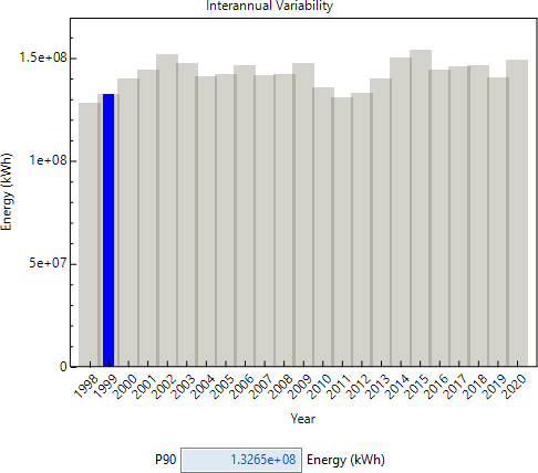

- In case I get the P50 from the uncertainty analysis of 54,137.9 MWh/year, this value does not need to be the same value of a single year “TMY”, isn’t it?
because the uncertainty analysis will calculate based on multi-year inputs (in this case there are 23 years (1998-2020)), while TMY represents the typical year over these 23 years.
Do I understand correctly? - I noticed that it seems the “P50/P90 Simulations” has been replaced by the “Uncertainty” simulation?
Just curious if it would be possible to obtain a daily energy generation at each PXX from the “Uncertainty” analysis? - Would it be possible to run an uncertainty analysis on different values, besides annual energy generation?
- Would it be possible to export the values from the “uncertainty” results, for example from the graph?
- Would it be possible to know the value of the inter-annual variability (aleatory uncertainty) from the multi-year inputs?

1. You can find a description of each input by clicking the "i" button next to the input's label:
2. Your interpretation of the values looks correct to me.

4. Yes, the new Uncertainty simulations replace the old P50/P90 ones for the Detailed PV and PVWatts models. The new feature shows you the year that represents the PXX value, so you can run a "regular" simulation by choosing the weather file for that year on the Location and Resource page and clicking Simulate. For example, this graph shows that the 1999 weather file generates the P90 annual energy value, so you could run a simulation with the 1999 weather file to see the daily profiles and other results.

7. The graphs show the interannual variability of annual energy caused by variability in the solar resource data. You would have to analyze the data in the weather files themselves to determine other values of variability.
