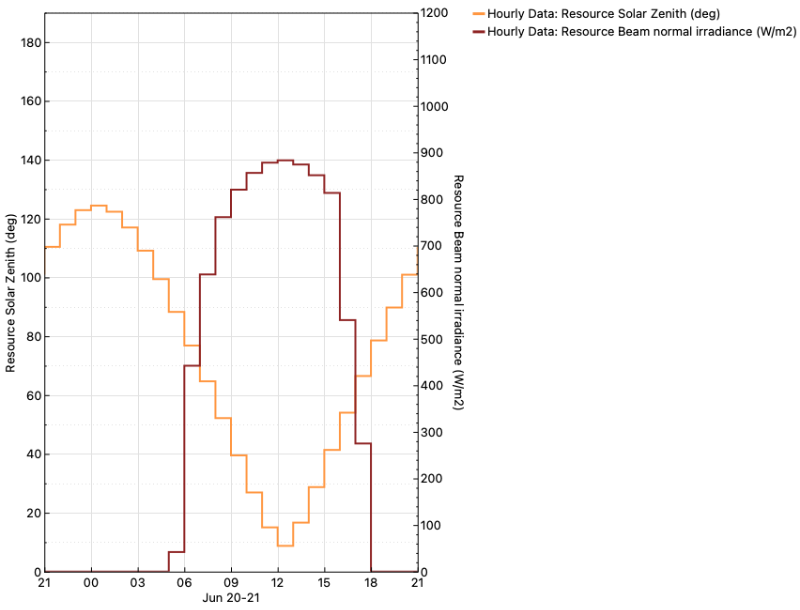

If that's the case, then why is there a warning message in red saying that they use a different time convention (see attached screenshot).
As well, when I run my model, my maximum DNI doesn't occur at the time of minimum zenith consistently (see attached as well). This seems to be a problem with interpreting the solar resource file as that's the only thing that would affect those two quantities.

The red warning is to let you know about the difference. If you are using sub-hourly solar resource data, it might be a consideration.
The coincidence of beam irradiance and sun zenith angle is easier to see in the graph if you change the model to "stepped lines" (click the wrench icon to change the mode). You can also use the data tables tab to compare the values.
