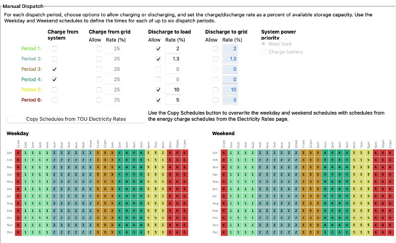

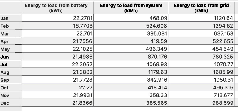

Really have enjoyed modeling with SAM!But perplexed by this one...and guessing I have incorrect settings. Am using a Net Billing model.Trying to model the battery discharging to meet load demands after solar availability, and avoid grid. Using an 18.5 kWh, 360AH battery. Have set TOU settings. See attached. Yet my "Energy to Load from Battery" Data is showing about 20kWh per month, when I'm expecting to see about 150 to 300 kWh per month (about 5 to 10 kWh per night). My actual results show an average of about 7kWh per evening over the past several day. Will really appreciate your guidance! Thanks!

Hi Bill,
You might try looking at the time series data for the period of interest to see what is happening with the battery. For example, you could check the battery state of charge during those periods to see if the battery has enough energy to discharge at the desired rate.
The discharge to load rate may also be limiting the battery discharge during those periods. You could adjust those inputs for the manual battery dispatch.
If you'd like me to help troubleshoot, please attach a copy of your .sam file.

Paul, Here's some additional actual data which might better show what I'm trying to model. Note that the battery discharges smoothly from about 6 pm until 8:30 am the next morning, when it starts recharging.
The actual results from that day shows very little grid usage, and 0.2 imported from the grid overnight.
I'm trying to have SAM reflect this type of scenario, which would show very little grid usage, and the battery handling after dark hours. (assuming proper weather conditions, beginning SOC, etc...)
So far, I haven't been unable to manipulate the settings to yield such results. I have looked at SOC Lifetime Hourly Data, which seems "reasonable", yet monthly values for battery to load remain at approx. 20 kwH (+/-) versus the 150 kWh (+/-) that I'm seeing in real time.
Thanks again for taking a look! Bill
