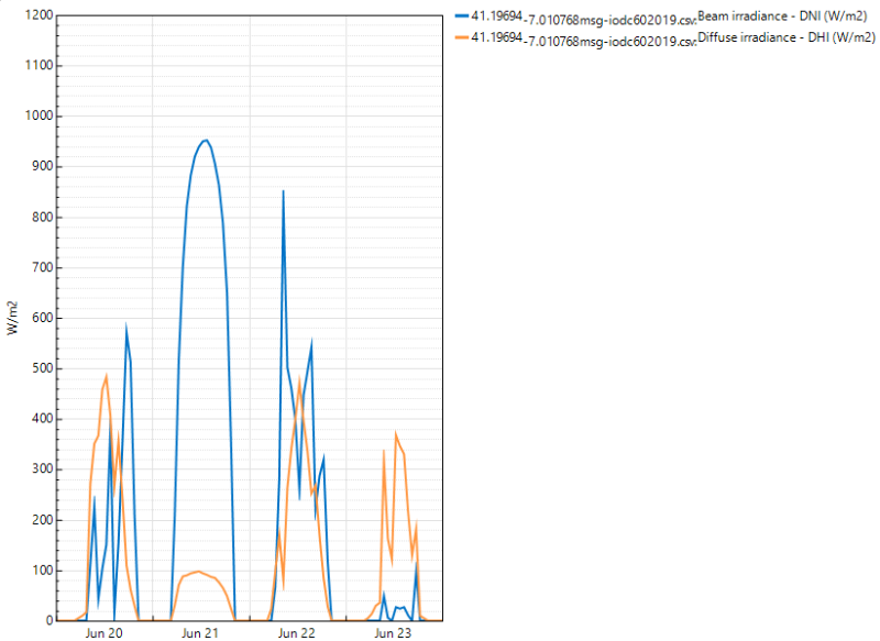

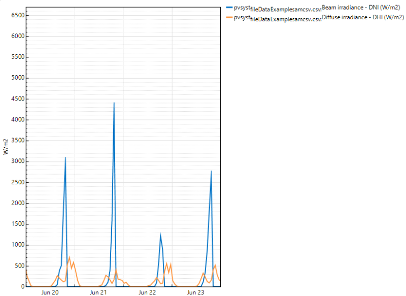

You can click the View data button on the Location and Resource data to see graphs of the data in the file (after converting it to the SAM CSV format).
For a file I converted for the latest file you attached, the DNI and DHI does not look correct to me. For example around June 21 the DNI peaks at almost 4500 W/m2 and the DHI at around 450:
Here's what the data looks like for an NSRDB file I downloaded from SAM using the Advanced Download option. This is for the same latitude and longitude, but data for 2019:
