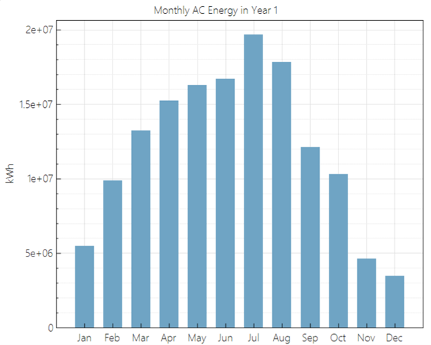

I used my own data in SAM to analyze the power generation efficiency of PV. The data is in units of every ten minutes. I found that the data can be correctly identified by SAM and I get satisfactory results.
But when I set 'Enable time series losses with custom periods', there is a problem with the software. For example, I set the loss of all moments in January to 100%, but it can be seen from the results that the losses in the first six months are all It is 100%, I suspect that under different time step data, the SAM software will scale the loss time.

Hello,Thanks for your answer.This is my project file and the pictures. Hoping that we could solve this problem!Best regardZHANG Chunyu
