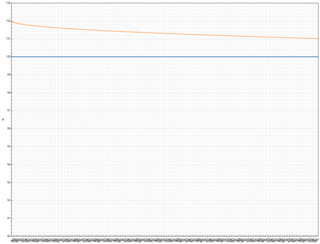

Hello Paul,
I'd like to calculate the calendar degradation occurring in a battery that is not cycling at all. From SAM I'm getting values of calendar degradation greater than 100%.
In the following graph you can see the "battery relative capacity to nameplate (calendar) (%)" and the "battery relative to nameplate (%)" I'm getting:
Both "battery relative capacity to nameplate" don't look right because at the end of the lifetime I would expect some calendar degradation.
Please can you review why that is happening?
Many thanks in advance
Best regards
Fran

Hi Francesco,
SAM's model for Lithium-ion NMC/Graphite assumes that the battery experiences some initial capacity fade at the beginning of its life. The initial capacity is slightly over 100% so that it levels out to 100% within the first few months of use.

many thank for your reply.
The system I was modelling is a li.ion LFP not NMC.
My question then is: how should I model a battery that at day 0 has 100% capacity and starts degrading according to li-ion lfp calendar degradation?

Replied by Paul Gilman on topic On the calendar degradation
Hi Fran,
You can use the "Custom" calendar degradation option to define your own degradation curve that starts at 100%.
