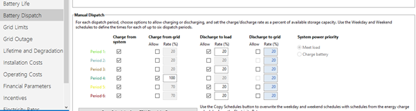

It looks like you are using SAM 2020.11.29. I would recommend using the latest version of SAM to get the most up-to-date battery dispatch options. In SAM 2022.11.21, separate manual battery dispatch options allow you to specify when to allow the battery to discharge to the load and grid:
Older versions of SAM did not allow the battery to discharge to the grid.

Thanks for the prompt response...apologies, I did check and thought I had the latest version but I was wrong. I have installed SAM 2022.11.21 and it has exactly what I need to model feeding back into the grid from the battery. The option to add grid outages as a time series in the new version is also really nice, particularly for our situation in South Africa at the moment.
