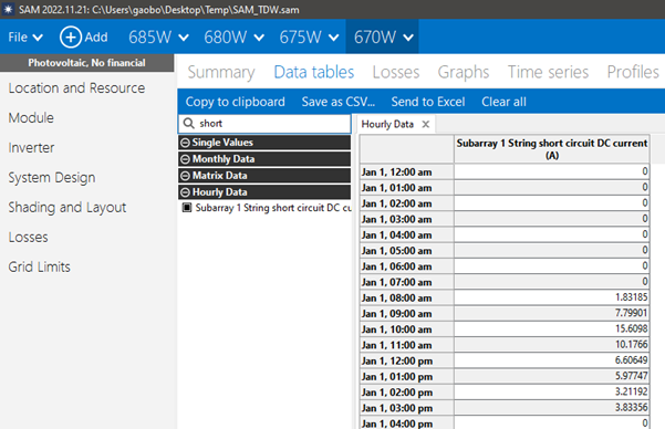

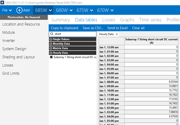

In my comparison, I found that the maximum Isc for the 685 W case is 26.28 Amps, and for the 670 W case it is 25.6. This is consistent with the higher Isc rating at STC for the larger capacity module.
I found the maximum value of "Subarray 1 String short circuit DC current (A)" on the Statistics tab of the Results page.
I also compared the time series data, and, at least for the first day at least, it appears that the system with the 685 W module has a higher Isc under operating conditions than the 670 W system:
These results are from the latest version of SAM, SAM 2022.11.21 r3.
Thank you for attaching your .sam file.
