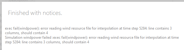

I used a text editor to delete the trailing comma(s) at the end of each data rows, and then tried running a Wind simulation in SAM and got a more helpful error message "error reading wind resource file for interpolation at time step 5284: line contains 3 columns, should contain 4." (Because of the two header rows, Time Step 5284 is equivalent to Line 5287, where time steps start at zero and lines start at one.)
