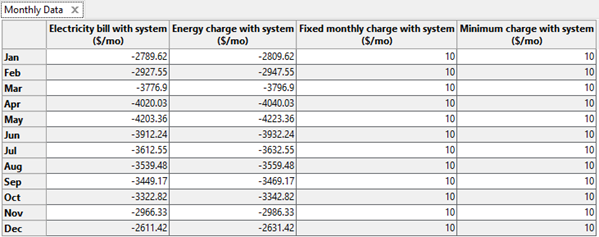

SAM applies the monthly minimum charge to the electric bill when the monthly bill is less than the minimum charge amount, but it does not force the total bill to be the minimum charge. In this case the monthly bill is the sum of the energy charge, fixed monthly charge, and minimum charge:
The description in Help is a little misleading. For the monthly minimum charge, it says "If the monthly electricity bill with system for a given month is less than the monthly minimum, the bill for that month is the monthly minimum charge." This only true if the monthly bill is positive. I will revise the description to make this clear.
