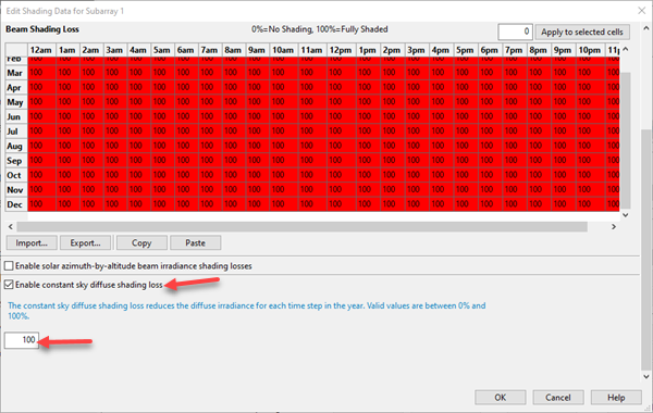

The shading factors you set to 100% only apply to the beam irradiance. The PV array generates some power from the diffuse sky irradiance and ground-reflected irradiance, which is why the shading losses on the loss diagram are not 100%. If you want diffuse irradiance to be blocked, you can check Enable constant sky diffuse shading loss in the Edit Shading window and set the diffuse loss to 100%.
You can plot the "Subarray 1 POA front beam irradiance after shading and soiling" and "Subarray 1 POA front diffuse irradiance after shading and soiling" variables on the Time Series or Heat Map tab of the Results page to see the beam and diffuse irradiance incident on the subarray.
