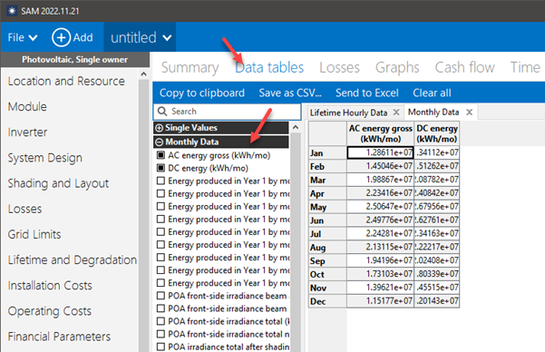

Can anyone please tell how to estimate the energy yield for each particular month ?
In the summary, I can see only for the whole year.

Just one more question: Can we also get the graphic plots for this data ?
Thanks a lot!

Hi Sahil,
The Summary tab of the Results page for some performance models shows a graph of monthly output values. Otherwise, you can use the Graphs tab to create a graph. You can always export the data from SAM and use external software to create graphs.
