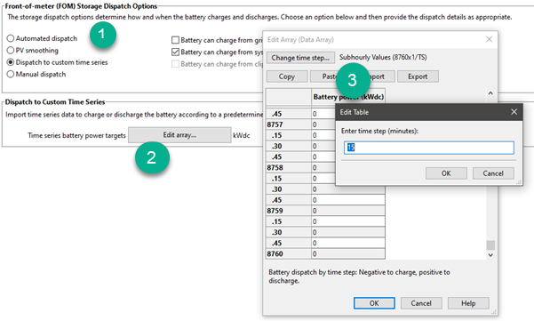

SAM does not automatically adjust the length of the custom time series dispatch array. If you choose a weather file with 15-minute time steps on the Location and Resource page, you have to set the time step for the battery dispatch to 15 minutes:
1. On the Battery Dispatch page, choose Dispatch to custom time series.
2. Under "Dispatch to Custom Time Series," click Edit array.
3. In the Edit Array window, click Change time step, type 15 for the time step in minutes, and click OK.
4. Use the Paste or Import buttons to set the 35,040 values in the table, and click OK.
