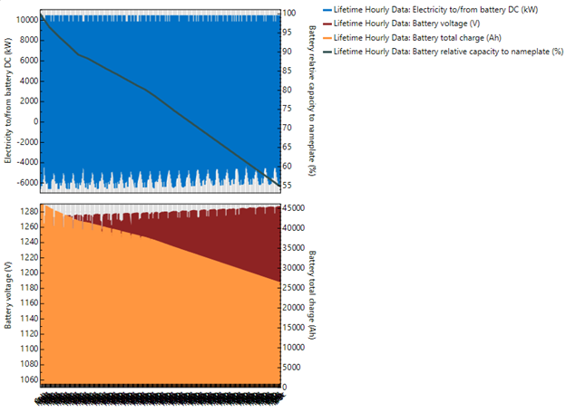

I looked on "Data Tables" to check how the capacity and power is degrading but I only see a degradation on total Capacity (MWh). From my understanding, if we have a battery bank of X Power (kW) and Y Capacity (MWh), degradation will have an effect on both factors because of the acumulation of internal resistans on battery cells (X-X*d1 and Y-Y*d2). Does SAM neglect this effect?
I Attached a summarized table (from data Table) and SAM file.

You can plot the battery total charge (Ah) and battery voltage (V) to see how those values change as the battery capacity degrades over time. This plot from your file shows the battery power, voltage, current and relative capacity to nameplate over the 25-year life of the project.
