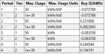

There are several typos in the 6A download but in the end I believe energy charge table should look like the screenshot below .

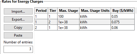

I could not see your screenshot, but here is an example of an energy rate structure that causes that error:
To fix the error, you could either add a second tier to Period 2, or remove Period 2.
For the 6A rate schedule in your example, you could define the rate table like this (use this as an example, please refer to the OpenEI data and rate sheet to get the correct numbers). For the periods with a single tier, I used two tiers with the same rate:
Note that I added up the rate and adjustment values from the OpenEI table because SAM does not have separate columns in the table.
