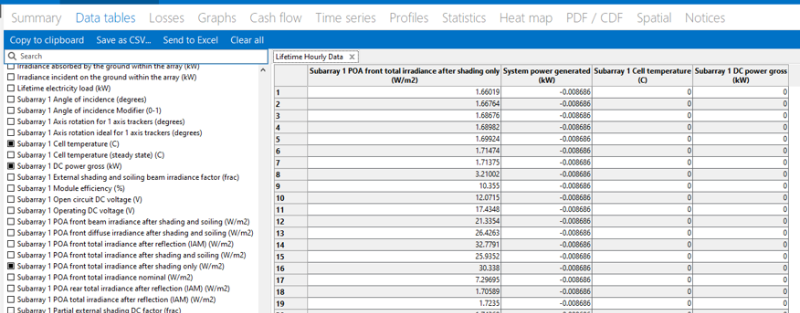

I am running a weatherfile with 'POA' as input, selecting 'POA from refernece cell' on the irradiance mode, and the results show correct Plane of Array irradiance but no values on the performance (DC power, etc..). Any suggestions appreciated
Notes on the issue:
-SAM 2022.11.21

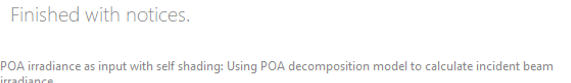

-Weaterfile attached, field data from NREL. I know it works because the POA values can be seen in the results, adn because I get the notice that I am using a POA for simulation when running:
-Tested on pysam, same issue (that's where I first encountered it)
-Tested the rest of the simulation with a similar field data weather file but with DNI and DHI provided and selected as the irradiance mode ('irrad_mod'), and that one did run, so it is something to do with the irrad_mod = 3 ('POA with reference cell') option
-Results showing performance values on 0:
Notes on the issue:
-SAM 2022.11.21

Hi Silvana,
This issue is caused by using POA irradiance data with self shading enabled. I'm not sure the POA option is designed to work with the self-shading model enabled.
The model should run with self shading disabled on the Shading and Layout page (subarray1_shade_mode = 0 in SSC / PySAM).
Is your intention to use POA data with SAM's self shading model?
