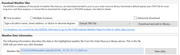

I am working on SAM 2021 version but the problem I am facing is that when I selected a day like 22 Dec after simulation it is not matched for 2021 or 2022. My question is that how can I select the exact date of 2021/2022 to run the simulation for concern day? Thanks

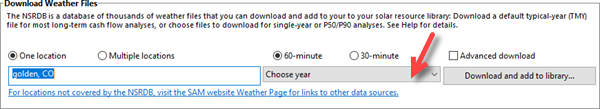

Hi Muhammad Irfan,
To run a simulation for a specific year, you need weather data for that year. You can download weather data from the NREL National Solar Radiation Database (NSRDB) from SAM's Location and Resource page with the "Choose year" option to download data for a specific year:

02 Dec 2022 03:54 - 02 Dec 2022 16:08 #11756
by Muhammad Irfan
Replied by Muhammad Irfan on topic How can I select Dec 22, 2021/2022 etc
Last edit: 02 Dec 2022 16:08 by Paul Gilman.

Hi Muhammad,
A SAM weather file contains a single year of data.
There are two types of weather files that SAM can download from the NREL National Solar Radiation Database (NSRDB):
The NSRDB does not provide data for the current year. After this year, it will take some time for NSRDB staff to process new data for 2022 and add it to the database.
- A typical metorological year (TMY) file contains combines data from different years so that the data represents the "typical" solar resource over a historical period of many years. See the NSRDB website for a description of TMY data:
nsrdb.nlr.gov/data-sets/tmy
- A single year file contains data from one year.
