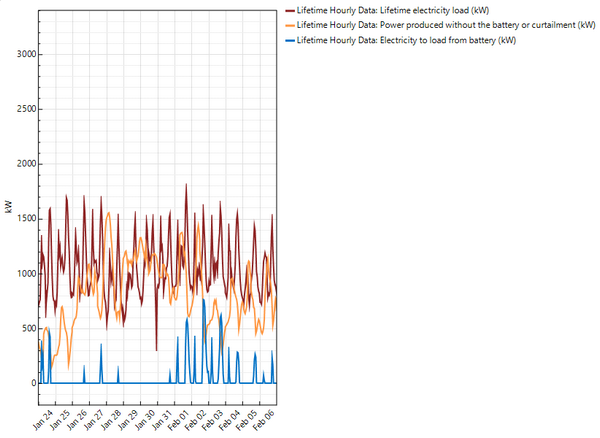

16 Nov 2022 16:50 - 16 Nov 2022 17:02 #11704
Replied by Paul Gilman on topic Battery charge to system spike.
Hi Brock,
Thank you for the description -- I see what you are trying to do. That's a bit of a stretch for SAM (a model like HOMER is better suited for this kind of analysis).
With the buy all / sell all metering option, all of the power delivered to the grid by the system is sold at the sell rate(s), and all of the power required by the load and to charge the battery is purchased at the buy rate(s). The net billing (excess generation calculated for each time step) or net energy metering (excess generation calculated from monthly totals) may be better options. Detailed descriptions of the options are in the "Metering and Billing Definitions" section of the "Electricity Rates" Help topic: samrepo.nlr.gov/help/electricity_rates.html
I think that will address Item 2 (negative savings).
For Item 1, it looks to me like the battery only discharges (blue) when the load (red) is greater than the system output (orange):
