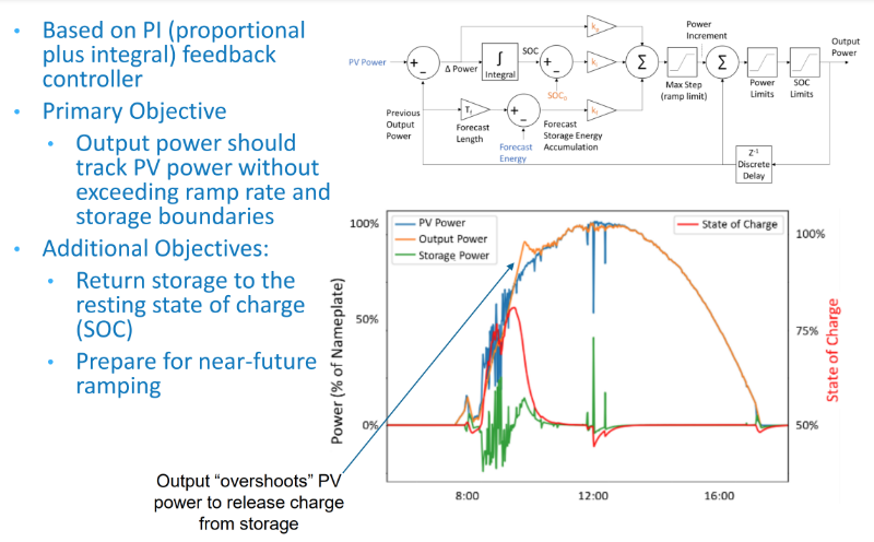

Hi support team,
I am currently working on some PV + BESS plants, the BESS has the purpose of avoiding rapid fluctuations and to control the ramp rate of the output generation. Based on this, I trying to use the PV smoothing dispatch option but I consider the information available in the help section about different variables and controller's multipliers no enough to grasp the entire concept about this.
Questions:
1. Is it posible to obtain, for example, a combination of battery bank size, variable's values, controller multiplier values to get the output power ramp rate shown in the webinar presentation of this dispatch option?
2. Is it posible that you share any paper that explain the theory concept behind this algorithm and how to play with the controller multipliers values to the desired results?
Carlos

Hi Carlos,
Attached is an example of the PV smoothing battery dispatch option with some additional documentation.
