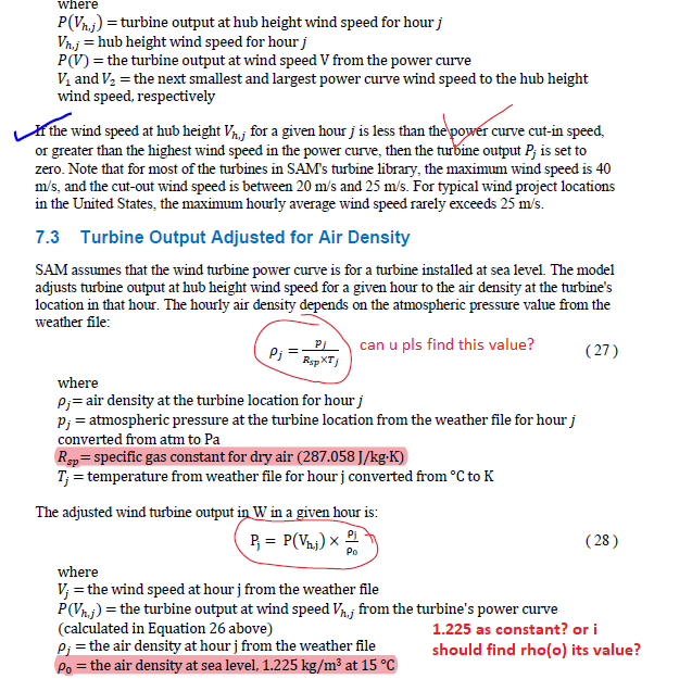

Hello Sir / everyone.
I want to ask how to calculate the turbine output at hub height wind speed?
I can see formula/equation 25, 26, 27 and 28 (page17-18) in MANUAL. but i am unable to appropriately use the values and that is
why my calculations by hand are wrong. can u pls solve it?
(screenshots and EXCEL FILE and screenshots are attached.)
guide me please, what does it mean by V1,V2 and P(V) (although i can read the description but i am unable to use the correct values and get the right result)
can u please solve any example? (take any wind turbine power curve in order to solve).

Sir honestly I did not get you. I am confused, doing the reverse math since yesterday and didn't get the right of these three equations. I need ur help in detail.
Can u pls do the manual (handwritten calculations for 2-3 steps pls)? I have attached an excel sheet, screenshots and manual to see the formula! pls favour me and do the hand calculation and let me understand pls.
How P(V1) is the power (in kW) from the power-curve at 100m? (at 100m, really? we know that cut-off speed is 25m/sec)! weather file (with name SAME) is attached.
SAM result excel sheet is also attached. and in this excel sheet, my calculations are also there. please show me how to use values and equations. Its a request sir pls.
The most important question is (to be specific) = in manual, it is written as: "see the screenshot in this msg". how to find rho j and rho o?
Sir, I request you to pls find the final answer of eq. 26, 27 and 28! PLEASE.
reply as soon as possible. (or can we talk on a phone call, sir?
Thank you so much.

Respected Sir,
can u please clear my this confusion (below explained): Query referring to the previous conversion on this topic (confusion is not clear)
Turbine hub height is 93m.
say for example for any hour j, I have four height and their wind speeds.
50m = 6m/s
80m = 7m/s
90m = 8m/s
100m = 100m/s
as the Turbine hub height is 93m.
Note: in SAM manual statement is written like this: "V1 and V2 = the next smallest and largest power curve wind speed to the hub height wind speed, respectively."
Q1 = now according to above SAM manual statement and as per given my heights and their wind speeds, what is the V1 and V2 value?
Q2 = and what is the value of P(V1) and P(V2) ?????
Note: in SAM manual statement is written like this: "P(V1) and P(V2) = the turbine output at wind speed V from the power curve"

Hi Hamza Ali,
In this case:
V1 = 9 m/s
V2 = 10 m/s (I think you typed a mistake. I assume you mean 10 m/s, not 100 m/s)
P1 = 1836 kW
P2 = 1965 kW
