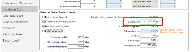

by Ivan
% Contingency (Balance of System Advanced Inputs) was created by Ivan
09 Aug 2022 16:20 #11338
Replied by Paul Gilman on topic % Contingency (Balance of System Advanced Inputs)
Hi Ivan,
That's a bug in the default input values for the Wind / Residential configuration.
The balance of system cost models (land-based and off-shore) are designed for large scale wind projects and are not appropriate for use with SAM's Residential or Commercial financial models. For these models, you should set value of the balanced of system cost input yourself in the line item under "Capital Costs."
