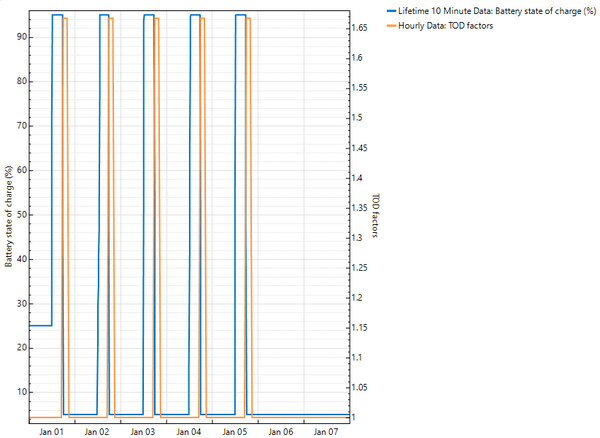

01 Aug 2022 16:16 #11307
Replied by Paul Gilman on topic Doubt on modeling battery in new version of SAM 2021 Revised 2
Hi Pao,
Attached is a version of your file with one case where the DC/AC ratio is 1 and one case where the DC/AC ratio is 1.8. For the DC/AC ratio = 1 case, the battery does charge and discharge in response to the TOD factors. This graph shows the battery state of charge in blue and TOD factor in orange for the first seven days of the year:
