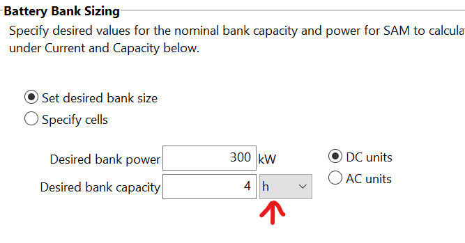

It seems like there is a disconnect between my system size (150 MWh) and how much the battery is actually outputting (in excess of 280 MW over multiple hours):

Please try creating a case that causes these unexpected results when you click the Simulate button by setting the inputs on the Battery Cell and System (and other input pages) to match the row in the parametrics table. That will make it easier to understand what might be causing the results that you see in the table of parametric results.
