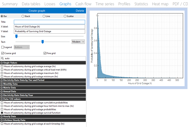

For Calculate hours of autonomy for a hypothetical outage, SAM calculates the number of hours your system design would meet the load without any power from the grid. To do this, SAM runs the normal simulation plus a series of simulations starting at each time step of the year to see how many time steps the system can meet the load with no grid power. It then reports "hours of autonomy" metrics to indicate the minimum, maximum, and average length of power outage that the system can meet the load. Depending on your system design, this calculation takes longer than a normal simulation because it requires starting a new simulation for each time step.
The outputs for this option the outputs include "Hours of autonomy" in the label:Single value
- Hours of autonomy during grid outage (min, avg, max): A count of the number of hours the system was able to meet the load without the grid.
- Hours of autonomy during grid outage critical load met (kWh): The total load met by the battery and system over the hours of grid outage.
- Cumulative probabilities
- Hour list from min to max
- Probabilities
- Survival function
