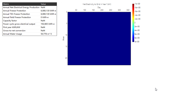

I installed the beta version of SAM, and tried several times, it crashed in most of times, while others only with results of "NaN" or incomprehensible results as below,
also i attached the SAM file which is simulated with the same meteo data and property table to my last post for your reference.
kind regards
Joey

05 May 2022 10:00 - 05 May 2022 10:01 #10928
Replied by Paul Gilman on topic Failed in simulation of Trough(phys) model with new HTF
Hi Joey,
We fixed another bug with the Physical Trough Model involving the Single Loop Configuration inputs on the Solar Field page. When you changed the number of assemblies per loop from the default 8 to 4, SAM did not correctly update the loop configuration variables.
We released a new Beta version SAM 2022.5.5 that should fix this problem.
To test this new Beta version:
Thank you for your patience.
- Download and install SAM 2022.5.5 Beta from
sam.nlr.gov/forum/forum-general/3847
. (I updated the download links for the most recent Beta version.)
- Open the original Sample.sam file you sent us. (This new Beta version will not open your newer Test.sam file that you created with the last Beta version.)
- Go to the Solar Field page and then switch to a different input page to make sure SAM updates the loop configuration inputs.
- Run a simulation.
