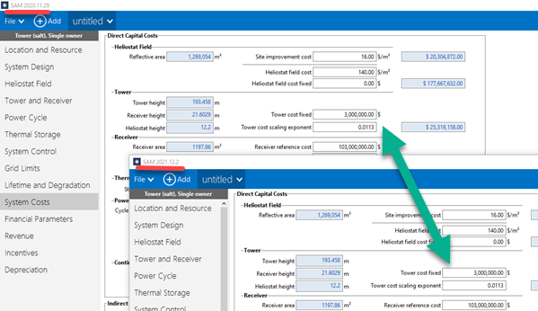

First, I think that between SAM v2020.11.29 and v2021.12.2 the default value for "tower cost fixed" changed from $8M to $3M, at least based on looking at my prior saved model files. I couldn't find a section in the release notes covering this, so I wanted to confirm whether this was the case (and, if so, inquire the reason: just incorporating more real-world data or something else?).

The default tower cost in SAM 2020.11.29 and 2021.12.02 is the same:
We try to keep the default costs in SAM consistent with the NREL Annual Technology Baseline: atb.nlr.gov/ .
Keep in mind that the purpose of the default costs in SAM is to provide a starting point for your analysis in SAM, not to serve as a reference for project costs.
SAM's power tower model defines the tower and receiver cost using a reference cost and scaling exponent for the solar field optimization, which uses the tower and receiver cost estimate to determine the tower height, receiver dimensions, and heliostat field that minimize the cost of energy. The scaling factor and polynomial equation makes it possible for the optimization routine to estimate the tower and receiver costs for different tower heights and receiver dimensions. That's different from the DOE method of estimating a $/kWt cost for the cost studies.
