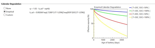

I am trying to understand how SAM calculates calendar degradation using the empirical Calendar Degradation for a Lithium-Ion LFP battery. Supposedly the equations below are used to calculate degradation, however when I try to replicate this calculation with the same equation and variables it gives me different results than the ones shown on the graph.
Looking into the code, the constant "0.00266" is supposed to have "1/sqrt(day)" units, however at a first glance it seems that for the graph values, hours (days*24) are used for the calculation instead of days. For the blue and red curve with moderate SOC, using hours gives me approximate values to the ones shown on the graph. But for the high SOC cases, green and yellow, days gives me the result shown.
I would like to understand if I'm making any mistakes or why this is modelled like such.
Thank you
Thank you

Thank you for the quick response.
I have now solved the issue, thank you! Seems that there are two differences between the formula presented and the one actually being used:
k_cal=0.00266*np.exp(-7280*((1/T)-(1/296)))*np.exp(930*((SOC/T)-(SOC/296)))
The parameters in bold differ from the presented formula and lead to mistakes when using them.
Thank you.
Miguel Brito
Thank you.

Hi Miguel,
Yes, I will fix the inconsistencies between the equations shown on the Battery Life page and the sample LK script.
For reference, here is the equation in the source code that SAM uses for the calculation during simulations:
github.com/NREL/ssc/blob/41eaf8a5a92b0f846cfa6d71012eaf54353c2640/shared/lib_battery_lifetime_calendar_cycle.cpp#L532
